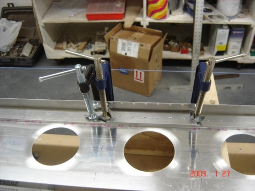

I lined up the spar webbs and the cap strips with a string to get everything straight and then clamped them all together with C clamps. Then I measured and marked where the rib attach angles will go. Then I made a tool out of a piece of left over cap strip to mark the rivet holes between ribs, and started center punching where rivets will go.
Right spar with cap strips clamped on
