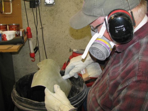

Step 3: Drilled a 3/4" hole in the F-1294A Upper Tailcone Fairing using a Unibit. Drilled two #30 holes on each side of the fairing at the designated locations on the plans.
Step 4: Trimmed the excess material from the Upper Tailcone Fairing in the same way as the lower fairing was done.
Had to use a brush handle to sand the curved edges. Lots of fiberglass dust. Respirator advised. I used the hearing protection mostly while cutting with the Dremel tool.
Using Available Tools for Sanding
