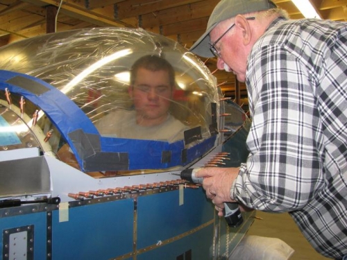

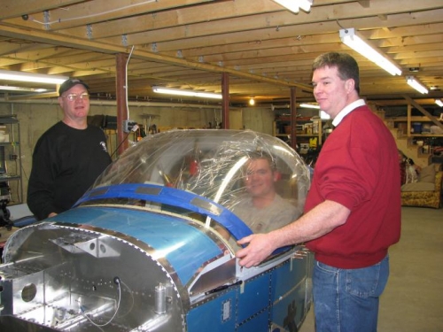

Step 1: Recruited my grandson Tyler to help with this step when he came over with his dad and uncle for their birthday parties. After he climbed aboard and became the first person to sit in the plane, we put the Canopy on the frame and clecoed in place.
Step 2: Clecoed the Canopy Skirts to the Canopy Frame. Match-drilled with a #30 plexiglass bit the upper row of holes in the skirts through the Canopy and the Attach Angles as Tyler held pressure on inside of the Attach Angles with a piece of wood. Clecoed each hole after drilling.

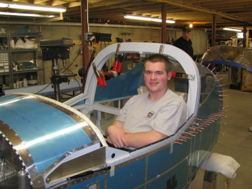

Step 3: Erik, his dad and Aarne, his uncle removed the Canopy and set Tyler free. The holes looked good. Good job Tyler!
