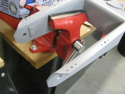

Test fit the Nose Gear to the Firewall Bottom. Found I had too much sealant on the rivet heads. Removed the sealant with rags and MEK.
Pg. 35-06
Machine countersunk the rivet holes on the outboard side of the Nose Fork Assy. Riveted the Anti-rotation Plates to the Nose Fork Assy.
Nose Gear Mounting Location
