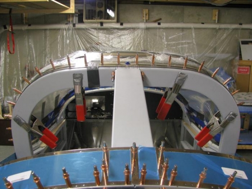

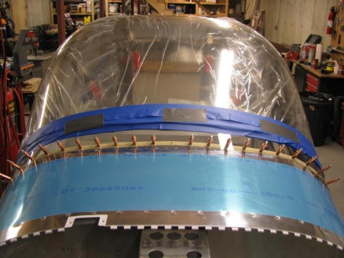

Step 3: After removing obscuring tape from the Canopy in the area of the rear bow, continued match-drilling #30 with a plexi dill the holes in the front and rear bow.

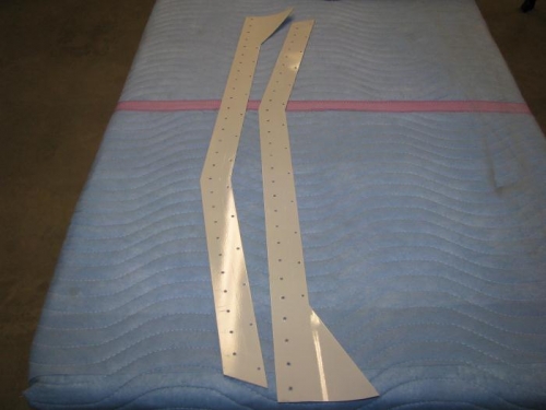

Clear coated the inside surfaces of the Canopy Skirts.
Rear Bow Drilled
Front Bow drilled
Painted Canopy Skirts
