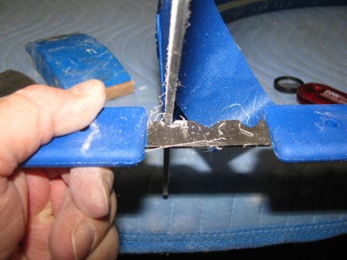

Completed trimming using 60 grit and 220 grit sand paper. Used the Avery plexiglass edge deburring tool to finish edges off.

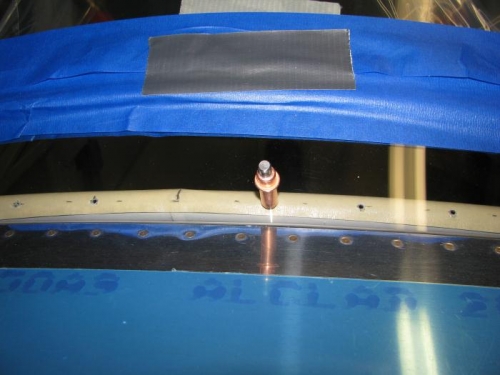

Step 2: Started drilling the front bow from the center with a #30 Plexi drill.
The plans call for alternately drilling the front and rear bows. I discovered I had left painters on the Canopy which obscured the holes in the rear bow, so I stopped at this point and will continue tomorrow.

Avery Deburring Tool
First Hole in Canopy
