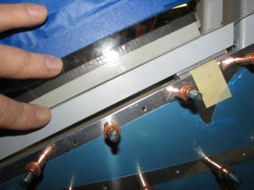

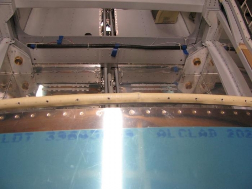

Step 1: Removed the Canopy and measured 2" on either side of the center weld on the Canopy Frame front bow and marked the contact line on the tape. Then marked every 2" along the line in aech direction. Pre-drilled #40 at each mark.
Elongated the Latch Hole and Straightened the front edge of the Canopy
Pg. 34-06
Step 2: Remounted the Canopy onto the frame and duct taped it down to hold it in place. The canopy at the bottom rear will need trimming.
