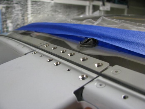

Step 1: Placed duct tape over the Attach Angles and the end of the Latch Tube. Placed a strip of regular masking tape on the front bow of the Canopy Frame.

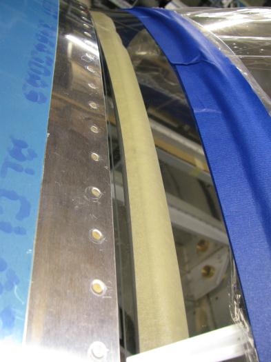

Step 2: Placed the C-1201 Canopy onto the Canopy Frame and aligned it. The forward outboard corners and Canopy Latch Hole addressed at the factory.

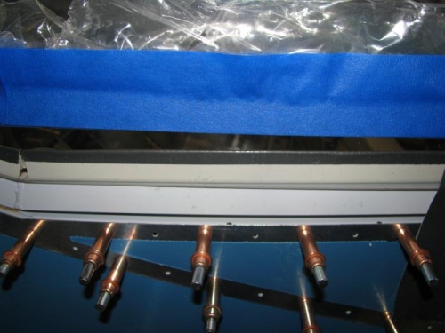

Step 3: With the Canopy still in place, taped it to hold it's position. Pushed down the front edge of the Canopy onto the front bow. This produced a visible line on the masking tape.
Taped Attach Angle
Taped Attach Angle
Taped Latch Tube
Taped Latch Tube
Taped Front Bow
Taped Front Bow
