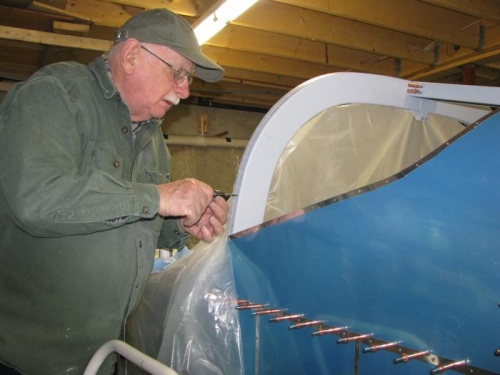

Step 4: Removed the Aft Window and opened up the holes with a #27 plexi drill. Used a hand drill to prevent grabbing of the lexan by the drill bit.
Step 5: Final-drilled #36 and tapped 6-32 the holes in the Roll Bar Frames.
Drilling Aft Window
Tapping Roll Bar
