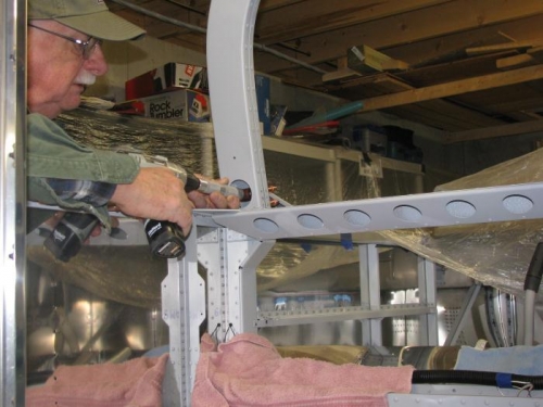

Step 1: Bolted the Roll Bar Bases to the Roll Bar Attach Plates.
Step 2: Clecoed the Roll Bar Assy. to the front face of the Roll Bar Bases. Clecoed the Support Frames to the Roll Bar Assy and Canopy Decks.
Step 3: Match-drilled #30 the holes in the sides of the Roll Bar Assy into the Roll Bar Bases.
Step 4: Deburred the Roll Bar Assy and Roll Bar Bases.
Step 5: Riveted the The Roll Bar Assy to the Roll Bar Bases.

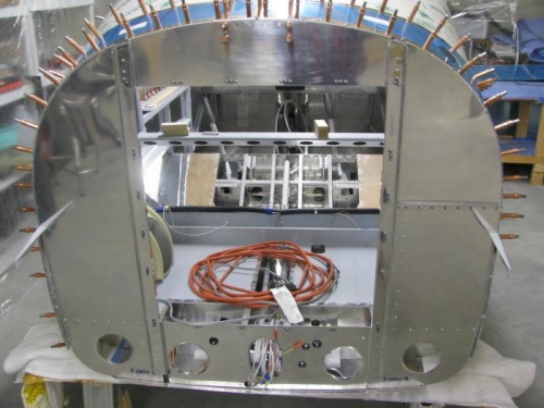

Pg. 24-05
Step 2: Though fluting is called for on the three long flanges of each side of the baggage bulkhead, they didn't appear to require any fluting.
Step 3: Completed dimpling, clecoing and riveting all the nutplates on the Baggage Bulkhead. Riveted the Baggage Bulkhead Channels to the Baggage Bulkhead and Baggage Floor.
Pg. 24-06
Step 3: Clecoed and riveted the F-1207J Attach Angles to the Rt. Baggage Bulkhead and Baggage Floor.
Deburring Roll Bar Assy
Baggage Bulkhead
Baggage Bulkhead
