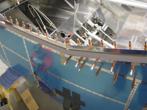

Step 2: Held the Attach Angles flush with the inside surface of the Canopy Frame then match-drilled #30 and clecoed the Attach Angles to the frame.

Attach Angles
Attach Angles
