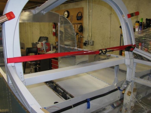

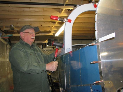

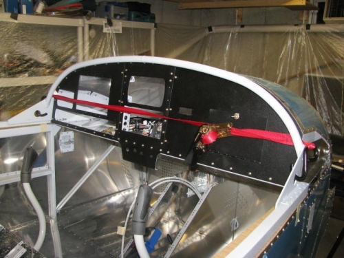

Canopy Frame was bowed out slightly. Adjusted with a heavy soft hammer and a cargo strap.
Adjusting aft Bow
Adjusting aft Bow
Cargo Strap
Cargo Strap
Adjusting Forward Bow
