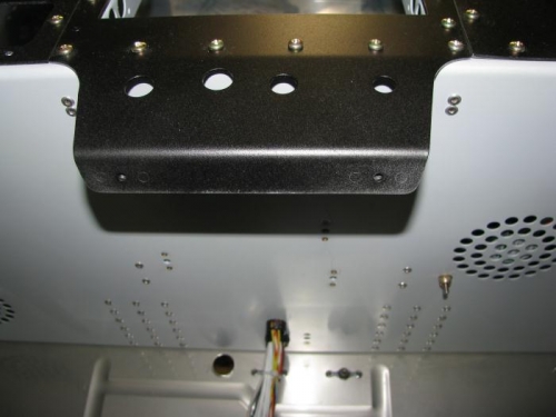

Step 1: Machine countersunk and riveted the nutplate locations on the F-1202A Instrument Panel. Used the AN515-6R8 Screw option for mounting the panel.

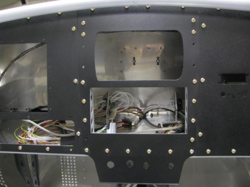

Step 2: Reinstalled the F-1240 Assembly, Instrument Panel Left, D-180 and Instrument Panel Right Map Box
Lower Nutplates
Lower Nutplates
Screw Option
Screw Option
F-1240 Assembly
F-1240 Assembly
