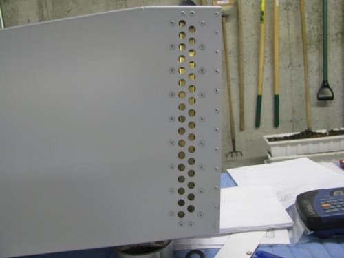

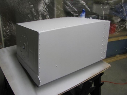

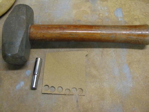

Cleaned and primed the Fuel Tank . Masked the Fuel Tank sight glass using cardboard dots cut from a Christmas sweater box. Cut the cardboard using a 1/4" deep socket and a heavy hammer on the anvil of my vise. No paint got onto the sight glass.
Fuel Tank Primed
Dot Cutting Tools
After Dot Removal
