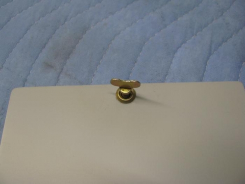

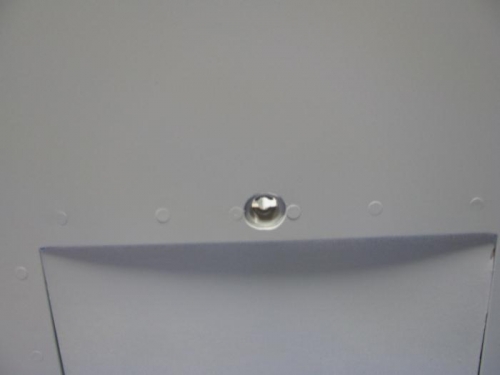

Step 5:Riveted the #40 holes in the Instrument Panel Right Map Box to the Map Box using AN426AD3 rivets all around. Used a rivet gun where the rivet squeezer would not reach. Riveted the camloc nutplate to the Map Box and Instrument Panel Right Map Box. Installed the camloc fastener and toothed washer. The camloc fastener was inserted through the Map Box door by compressing the spring and manuvering the ears through the Map Box door.
Pg. 29-07 Rev.1

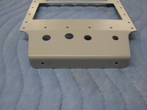

Step 1: Machine Countersunk the nutplate rivet holes and riveted the nutplates to the F-1202A Instrument Panel.
Map Box Nutplate
Map Box Nutplate
Camloc Installed
Camloc Installed
