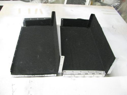

Reworked the Map Box. Attempted to install felt lining in the box, but had problems final-drilling the Map Box hole for LP4-3 rivets. The drill bit kept snagging the lining and tearing it, so I removed it. Next time I'll predrill the holes before lining the box.

Felt Lined
Felt Lined
