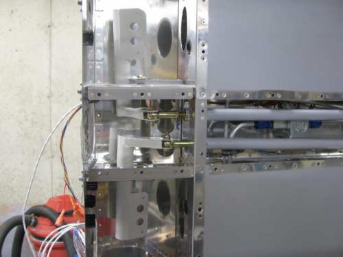

Step 6: Attached the outboard ends of the Control Stick Pushrod Assemblies to the Control Sticks.
Step 7: Attached the inboard ends of the Control Stick Pushrod Assemblies to the Flaperon Mixer Bellcranks.
Pg. 32-06
Step 2: Passed the two Flaperon Pushrod Assemblies through the holes in the Center Section and F-1206A Bulkheads.
Step 3: Bolted the forward end of the Flaperon Pushrod Assemblies to the Flaperon Mixer Bellcranks.
Step 4: Bolted the WD-1215-L&R Flaperon Torque Arms to the Bearing Brackets.
Step 5: Attached the aft end of the Flaperon Pushrod Assemblies to the Flaperon Torque Arms.

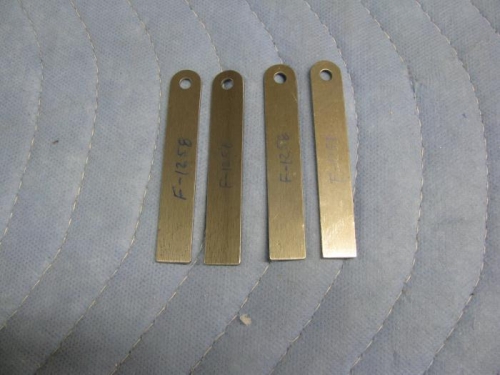

Deburred (4) F-1258 Rudder Cable Links.
Flaperon Mixer Connections

Rudder Cable Links
Rudder Cable Links
