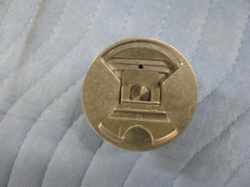

Step 4: Disassembled the T-406A Fuel Cap. Drilled the #40 vent hole through the cap casting and washer casting. Deburred the vent holes and reassembled the fuel cap.

Fuel Cap Vent
Fuel Cap Vent
