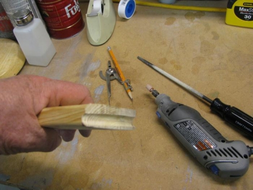

Made a tool to reform the fuel line to achieve clearance with the Flap Handle Assy. Placed the tool on the fuel Line and struck end with a hammer. It was fabricated in accordance with the "In The Shop" article by Ken Scott on page 8 of the 3-09 issue of RVator on the Van's web site.
Checked the clearance of the flap handle when installed. It was greater than 1/8". Care must be taken when reforming the Fuel Lines not to dent the Bottom Skin.
Using Tube Reformer
Using Tube Reformer
Business End of Tool
