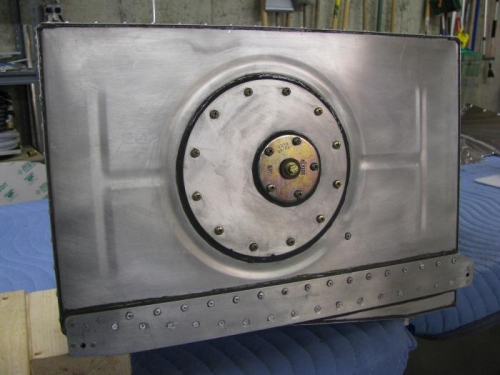

Brief Description:  Fuel Tank
Pg 37-06
Step 9: No additional sealant needed for for nooks and crannies. Installed the Res Sender Plate and Sending Unit with 1/16" of sealant between surfaces. Installed and tightened screws until sealant bulged.
Section 37
Cleaned excess sealant from previous work on tank.
Fuel Tank Closed
Fuel Tank Closed
