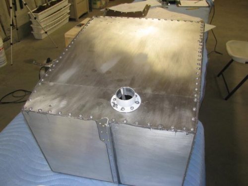

Brief Description:  Fuel Tank
Pg 37-06

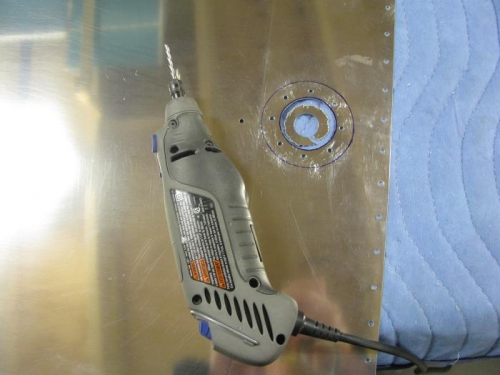

Step 5: Deburred the holes. Will prime the Flange after excess tank sealant is removed. Removed the rag and cleaned the chips.

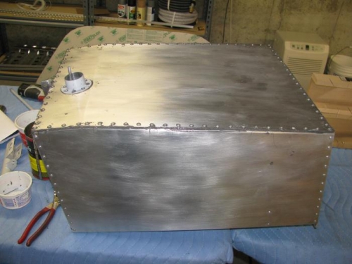

Step 8: Riveted the Top Tank Skin to the Fuel Tank Assembly. Riveted the Flange to the Fuel Tank Assy. Installed the Fuel Return Line to the AN 832-4D Bulkhead Fitting.
Hole cut in Tank Top
Tank Top riveted
Tank Top riveted
Flange riveted
Flange riveted
