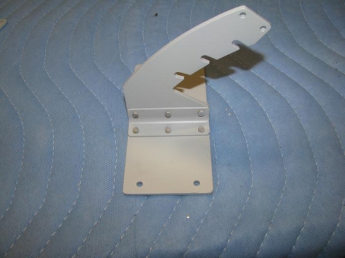

Step 6: Separated and deburred F-1266C Flap Detent Bracket Angles and F-1266AD Flap Detent Bracket/Stop.
Step 7: Attached Flap Detent Bracket Angles to the Flap Detent Bracket.
Step 8: Clecoed the the Flap Detent Angles to the F-1266B Flap Detent Bracket Plate.
Step 9: Match-drilled #30 the holes from the Flap Detent Bracket Plate into the Flap Detent Angle without holes.
Step 10: Machine countersunk the holes in the bottom side of the Flap Detent Bracket Plate.

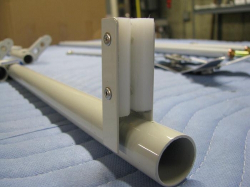

Step 6: Cut the F-1261 Spacer into four parts.
Step 7: Positioned the Spacers, the Match-drilled #30 the holes from the Torque Tubes into the Spacers.
Step 8: Final-drilled #12 the holes in the Spacers material.
