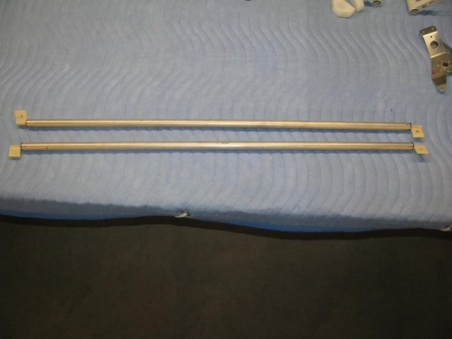

Pg 32-06
Step 1: Continued making the two Flaperon Pushrod Assemblies from the F-1265 Flaperon Pushrods and supplied hardware.

Flaperon Pushrod Assys
