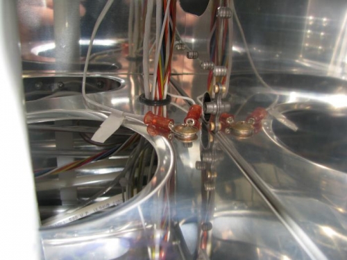

Step 5: Routed the PTT- P and PTT- CP Push-To-Talk Harnesses through the Seat Rib snap bushings inboard of the Control Sticks.
Step 6: Stripped the ends of each F83 PTT Ground Wire and crimped on ring terminals.
Step 7: On the left side of the aircraft I connected the F83 and B183 ring terminals to the inboard Seat Rib.
Step 8: On the right side of the aircraft I connected the F83, B183 and B54 ring terminals to the inboard Seat Rib.

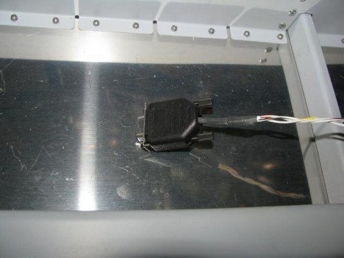

Step 2: Separated the F58 (WHT/ORG), F59 (WHT/YEL) F60 (WHT/BLK) wires from the TUNNEL Harness and slipped them through the ES HST 3/16 X 2" Heat Shrink. Inserted the pins into the ES-205203-3 9-Pin D-Sub Female connector according to the plan diagram. Assured each wire was snapped in place.
Step 3: Slid the Heat Shrink close to where the wires exit the 9 PIN BSHELL Female Backshell and activated the heat shrink with a heat gun.
Then installed the backshell on the 9-Pin D-Sub Female Connector.
PTT Wires
PTT Wires
9-Pin D-Sub Connector
Ground Wires
Ground Wires
