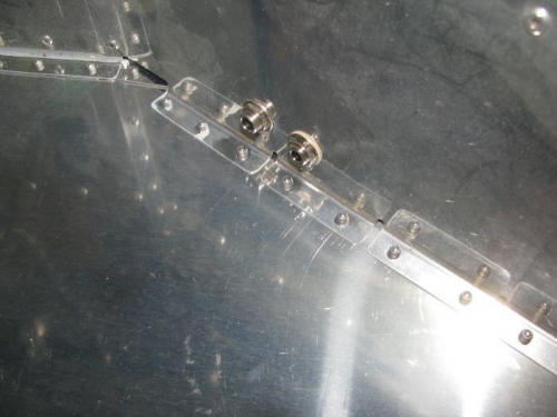

Tightened OAT Probe using a 9/16" crows foot.
Pg 31-10
Step 4: Separated the HEADSET Harness into Pilot and Co-pilot harnesses.
Step 5: Removed the F-1270B ASSYs and installed the Pilot and Co-pilot jacks into the Seat Ramp Floors.
Step 6: Routed the Pilot and Co-pilot harnesses inboard through the all the Seat Ribs.
Step 7: Routed the Pilot and Co-pilot harnesses, B148 and MUSIC harness forward through the F-1203A and F-1202F Bulkheads, Fuel Flo cushioned clamp, up the aft side of the firewall, over the rudder pedals and through the fwd snap bushing in th Panel Base.
Step 8: Routed the Pilot and Co-pilot harnesses through the snap bushings in the Rt Instr Stack Support. Labeled the harnesses Pilot and Co-pilot.
Step 9: Routed the B148 wire through the lower snap bushing in the Lt Instr Stack Support then out through the Firewall Upper.
Step 10: Routed the MUSIC harness through the lower snap bushing in the Lt Instr Stack Support, through the cushioned clamp near the Lt CPU FAN.
tion.
Headset Jacks
Headset Jacks
