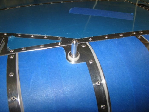

Step 2: Installed the WH-RV12-OAT and routed the harness through the Seat Ribs to the center of the aircraft.

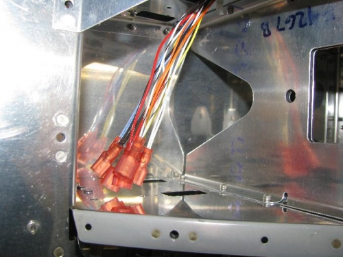

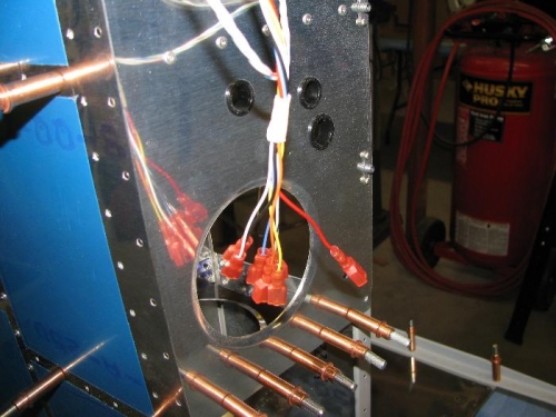

Step 6: Separated from the OPTIONAL harness the seven wire group.
Stripped the ends and routed them through all but the outboard Seat Rib on the left side then back through the rectangular opening.
Step 7: Created the seven wire B170 Autopilot Harness by trimming the WIRE AUTOPILOT SERVO to 85" and stripping the wires on one end.
Step 8: Matched the YEL, BLU, WHT and BLK wires of the OPTIONAL harness and B170 AUTOPILOT harness and crimped them together in the same female connectors. Matched the remaining wire colors and crimped them together in the same male connectors. Routed the B170 AUTOPILOT harness back through the Seat Ribs to the center of the aircraft. Tyraped the harnesses to the rib at the rectangular opening.
Step 9: Created and labeled two B183 (WHT) Wing Ground Wires from 18 gauge wire. Stripped one end of each and added a female spade connector. Attached the ground wire to the F-1270B ASSYs and routed the wires inboard through the Seat Rib snap bushings. Attached ring terminals to the other ends.
Step 10: Routed the OAT Harness and Autopilot Harness along the system blocks, through the Fuel Pump cushioned clamp and through the F- 1206A and F-1207B Bulkheads.
Step 11: Stripped the ends of the seven Autopilot Harness wires. Crimped female spade connectors to the YEL, BLU, WHT and BLK wires. Crimped male connectors to the RED, ORN and WHT/BLK wires.
