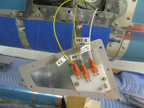

Step 1: Routed the OPTIONAL harness over the rudder pedals, through the fuel flow clamp and through the F-1202F and F-1203A Bulkheads.
Step 2: Separated out and routed the L72 (YEL/RED) wire through the left Seat Rib snap bushings. Routed the L75 (YEL) wire through the right side Seat Ribs.
Step 3: Made and labeled a 53" B184(WHT) Nav/Strobe Power Wire from 18 gauge wire and stripped the ends.
Step 4: On the left side crimped the B184 and L72 wires together in the same female spade connector. Connected to the left F-1270B ASSY.
Step 5: Routed the Nav/Strobe Power wire through the right side Seat Ribs and crimped on a female spade connector. Connected to the right F-1270B ASSY.

F-1270B ASSY Right
F-1270B ASSY Right
