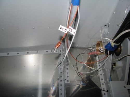

Brief Description:  Fuse Wiring Harness
Pg 31-05
Step 3: Laid the TUNNEL harness in the System Blocks and through the forward snap bushing in the F-1204 Center Section Assy.
Step 4: Separated the Q54 Fuel Level wire and F55 GPS Data Out wire. Routed them through the upper snap bushing in the Center Section Assy and into the Wire Run Conduit, then out the right end. Attached a ring terminal to the end of the Fuel Level wire.
Step 5: Separated the F50 Spar Pin wire and routed up through the Wire Run Conduit and out the left end.
Step 6: Routed the remaining TUNNEL harness Center Section Assy. Separated and stripped the P34 Fuel Pump Power wire. Attached connector to the P34 and red Fuel Pump wire then connected them together.
Step 7: Removed the left hold down bolt. Final-drilled the cushion clamp 1/4 and inserted the wires. Reinstalled the bolt through the ground wire ring connector.
Fuel Levl/GPS Data
Fuel Levl/GPS Data
