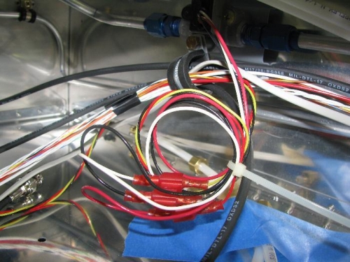

Step 10: Separated the Q-51(BLK), QA-52(YEL) and Q-35(RED)wires and stripped the ends. Attached female spade connectors to the black and yellow wires and a male connector to the red wire.
Step 11: (Flo-Scan) Stripped the wires and attached male connectors to the black and white wires and female connector to the red wire. Attached the connectors black/black, yellow/white and red/red.

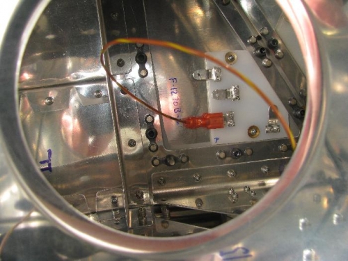

Step 1: Routed the WH-RV12-Tunnel harness through the snap bushings in the F-1202F and F1203A Bulkheads.
Step 2:Separated and routed the Stall Warn wire through the left Seat Ribs. Stripped and crimped the wires with female connectors. Secured the connectors to the F-1270B ASSY on the left side.
Flo-Scan Wires
Flo-Scan Wires
Stall Warn Wire
Stall Warn Wire
