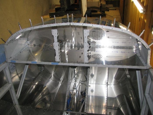

Brief Description:  Fwd Upper Fuse
Cleaned off excess sealant from rivet heads.
Pg. 29-05
Step 8: Screwed the Upper Fwd Fuse Skin to the F-1201A Assy, Fuse Side Skins and Canopy Ribs. Screwed the F-1240B Assy to the UpperFwd Fuse Skin.
Step 9: Dimpled the nutplates and rivet holes in the Panel Attach Strips. Riveted the nutplates to the Panel Attach Strips.
Step 10: Clecoed and riveted the Panel Attach Strips to the Upper Fwd Fuse Skin.

Upper Fwd Fuse Skin
Upper Fwd Fuse Skin
Panel Attach Strips
Panel Attach Strips
