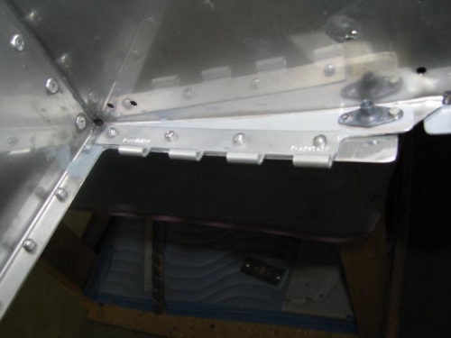

Step 2: Match-drilled #30 the the Mid Cowl Hinges to the Firewall Spacers and Side Skins. Deburred the parts.
Step 3: Clecoed and riveted the Mid Cowl Hinges to the Firewall Spacers and Side Skins.
Step 4: Dimpled the nutplate rivet holes, then riveted them to the F-1201A Fuselage Assy.

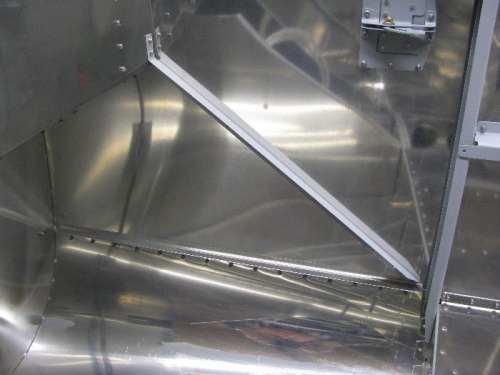

Step 5: Clecoed the riveted the Forward Skin Stiffeners to the F-1201A Assy. and Fuselage Side Skins.
Mid Cowl Hinges
Mid Cowl Hinges
Fwd Skin Stiffeners
Fwd Skin Stiffeners
