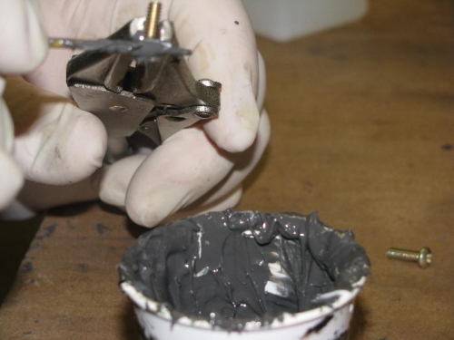

Step 2: With a toothpick, coated the underside of the screw heads before inserting into the tank. Used a pair of small vice grips to lightly hold the screws.

Coating Screw Heads
Coating Screw Heads

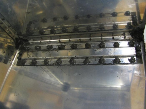

Nuts Sealant Covered
