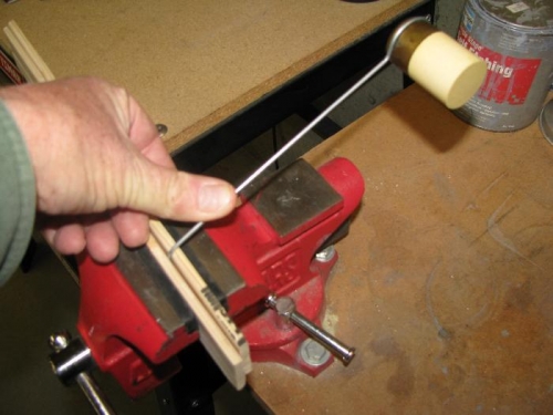

Step 3: Bent the IE F-385B Float Arm to the shape of the template. Inserted Float Arm in to the Fuel Sending Unit and snapped into place.

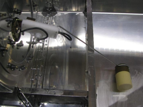

Step 4: Temporarily attached the Res Sender Plate, Gasket and Fuel Sending Unit to the Fuel Tank Assy. Checked the clearance of the Float Arm and adjusted for clearance and travel.
Bending Float Arm
Bending Float Arm
Checking Clearance
Checking Clearance
