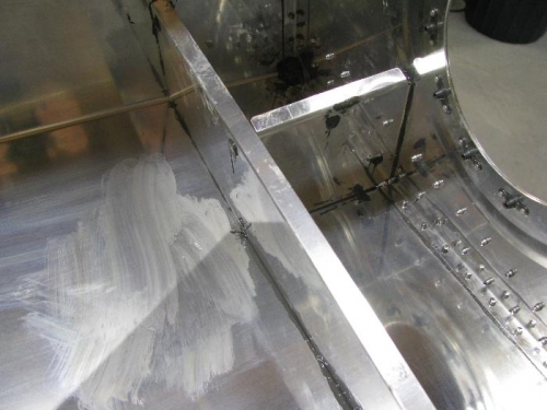

Step 1: Riveted the Fwd Baffle and T-1208 Baffle to the Main Tank Skin and together. Verified the fuel passages were open and the outbd passage and tool holes were sealed.
Step 2: Riveted the Fwd Baffle to the Fwd Bulkhead.
Step 3: Adjusted the joggle of the Aft Tank Bulkhead top flange.
Step 4: Riveted the Aft Tank Bulkhead to the Main Tank Skin.
Step 5: Applied sealant to the inside bottom corners.
Step 6: Riveted the Attach Angle to the Aft Tank Bulkhead.
Baffles Installed
Baffles Installed
Aft Tank Bulkhead
Aft Tank Bulkhead
