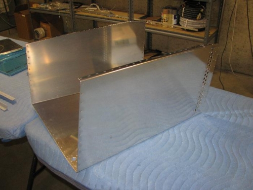

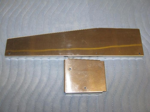

Deburred T-1205 Fwd Tank Bracket. Removed vinyl, deburred and prepped for paint the T-1201 Main Tank Skin. Deburred the T-1208 Baffle.
Pg. 37-02
Step 6: Machine countersunk the nutplate rivet holes on the front side of the Fwd Tank Bracket.
Step 7: Machine countersunk #30 the lower row of hole and top rt two holes in the Fwd Tank Bracket.
Step 8: Riveted the nutplate to the Fwd Tank Bracket.
Main Tank Skin
Main Tank Skin
Tank Baffles
Tank Baffles
