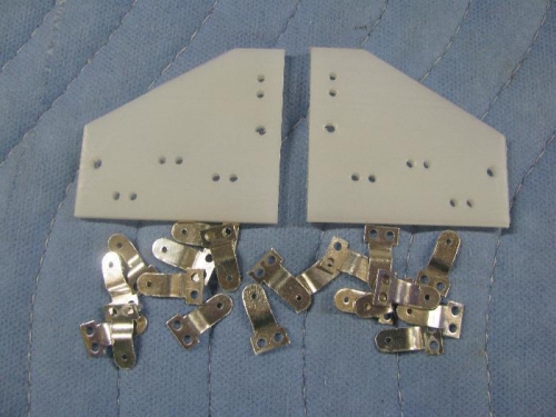

Step 1: Clamped two PS UHMW sheets to the Drill Template and drilled all holes #40. Final-drilled #30 two holes as indicated on the plans. Removed the template and trimmed each part to the trim line.
Step 2: Cut apart the VA-262 Terminal Tabs.

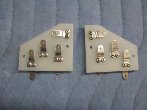

Step 3: Riveted the Terminal Tabs to the Terminal Blocks.
Terminal Tabs & Blocks
