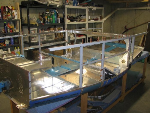

Deburred & primed F-1248B-L&R Fuse Pin Latches. Temporarily skinned Lt. & Rt. sides.
Pg. 23-06
Step 1: Riveted the F-1202L Gussets to the L&R Bulkhead Side Channels.

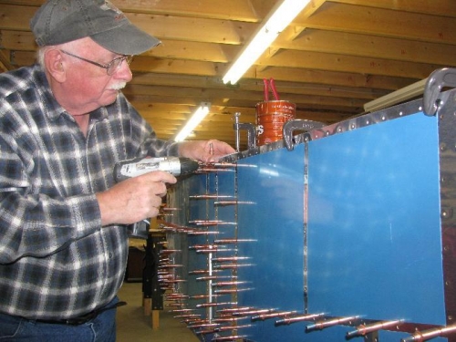

Step 2: Clecoed the Fuselage Side Skins to the fuselage skeleton. Aligned the Canopy Decks and Longerons before clamping the longerons to the fuselage skin. Aligned the Longerons and Roll Bar Attach Plates then clamped them.
Step 3: Match-drilled #30 and clecoed the Rt. Side Skin, Roll Bar Attach Plate and Longeron.
Fuse Frame
Fuse Frame

Drilling Longerons
Drilling Longerons
