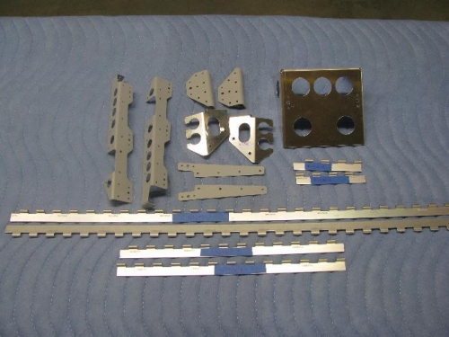

Brief Description:  Fwd Upper Fuse
Pg. 29-03
Step 7-9: Separated, deburred and primed F-1202J- L&R Inst Stack Angles, F-1202K-L&R Instr Stack Supports and F-1202M- L&R Canopy Attach Doublers. Deburred and primed F-1201R Antenna Shelf, F-1201P-L&R Firewall Spacers.
Pg. 29-02
Step 1: Cut two 4 1/4 lengths of AN 257-P3 piano hinge to make F-12116-L&R Mid Cowl Hinges. Cut off unused loops from hinges.
Step 2: Cut two 26 lengths of AN 257-P3 piano hinge to make F- 1201J&K Upper Cowl Hinges.
Fwd Upper Fuse parts
