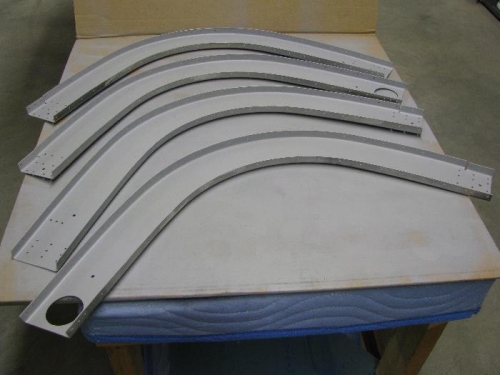

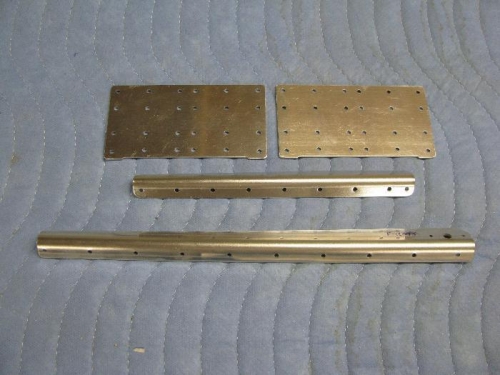

Deburred F-1231E Splice Plts., F-1231B&C Roll Bar Straps and F-1207 Brace Angle. Primed ID's of Roll Bar Frames.
Pg. 24-02

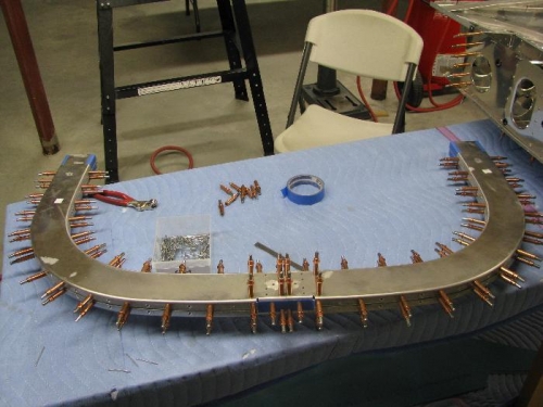

Step 1: Shaped the bends of the Roll Bar Straps on the edge of the work table. Clecoed the Roll Bar Assy. together.
Step 2: Started Final-Drilling #30 all of the #40 holes in the Roll Bar Frames and Roll Bar Straps.
Roll Bar Frame ID's
Roll Bar Frame ID's
Splice Plts / Angles
Roll Bar Assy Clecoed
