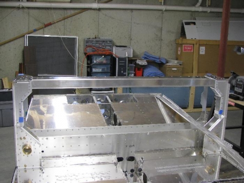

Date:  9-7-2009
Number of Hours:  4.00
Brief Description:  Side Skin; Roll Bar Struct./F-1207 BHD
Section 23
Painted ID of Mid-fuse Brace.
Section 24
Deburred F-1231A-FL&R and F-1231A-AL&R Roll Bar Frames.
Pg. 23-03
Step 3: Riveted the Mid-fuse Brace to the aft side of the Aft Bhd Sides.
Step 4: Riveted the Roll Bar Attach Plates and Mid-fuse Brace Close-out to the Mid-fuse Brace and Fwd Bhd Sides.
Mid-fuse Brace
Mid-fuse Brace
