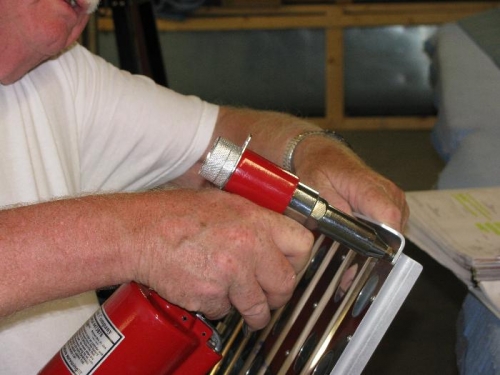

Step 3: Riveted the Aft Seatback Brace Hinges to the Seatback Braces. Manufactured heads on Seatback Brace.

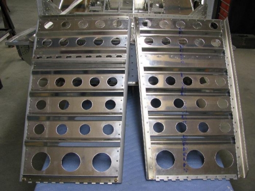

Step 4: Clecoed the Upper, Lower and F-1237C-L&R Seatback Angles to the Seatbacks. Final-drilled #12 the holes in the lower corners of the Left, Right, Lower Angles and Seatback. Disassembled an deburred.
Step 5: Riveted the Upper Seatback Angle to the top row of holes in the Seatback. Manufactured heads on Seatback. Left end holes open.
Step 6: Riveted the Fwd Seatback Brace Hinge to the Seatback. Manufactured heads on Seatback.
Step 7: Riveted the Lower Seatback Angle and Seatback Hinge to the Seatback. Manufactured heads on Seatback Hinge. Left end holes open.
Step 8: Riveted the L&R Seatback Angles to to the Seatbacks using the appropriate rivets. Manufactured heads on the Seatback Angles. Bolted the lower corners using the called out hardware.

Riveting Seatbacks
Riveting Seatbacks
Complete Seatbacks
Complete Seatbacks
