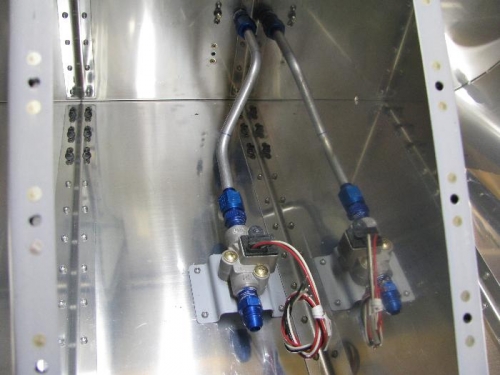

Step 1: Installed the fuel fittings on th FLO-SCAN Fuel Flow Meter, then installed the assy. onto the FO-SCAN Mount Bracket.

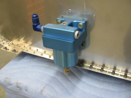

Step 2: Installed the fittings, plugs and drain onto the GAS-5 Gascolator. Safety wired the four screws on the Gascolator.
Step 3: Installed the Gascolator to the Firewall Bottom. Installed the Straight Nipple to Pipe fluid fitting through the Firewall Bottom into the Gascolator.
Step 4: Made the 8 3/4 Fuel Line Floscan-Firewall. Installed the nut and sleeve and flared the Gascolator end. Bent the tube using the template. Add nut,sleeve and flared the Floscan end. Attached the fuel line assy.
Gascolator
Gascolator
Fuel Line Floscan-Fwall
