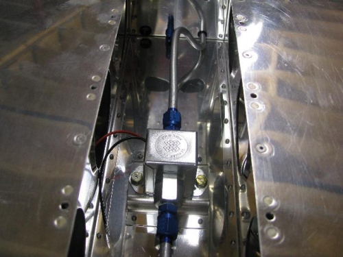

Step 8:Riveted the Fuel Valve Bracket to the Bottom Skin.
Pg. 28-03
Step 4: Installed the Fuel Line Tank-Pump to the Fuel Pump.

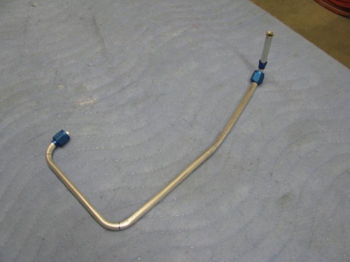

Pg. 28-04
Step 1: Made 40 1/2" Fuel Line Pump-Valve. Installed nut and sleeve and flared the end.
Step 2: Made an S turn in Fuel Line Pump-Valve between the pump and the Center Section Aft Bulkhead.
Step 3: Inserted the Fuel Line Pump-Valve through the snap bushings in the F-1204A and Center Section Aft Bulkheads. Inserted the fuel line through F-1203A Bulkhead. Attached the line to the Fuel Pump and formed the line into the System Blocks. Added an S bend to the line to align it with the fuel valve. Cut the line to length.
Step 4: Detached the nut from the Fuel Pump to allow adding the nut and sleeve and flaring the end of the line on the valve end.
Step 5: Connected the fwd and aft ends of the Fuel Line Pump-Valve.
Fuel Line Tank-Pump
Fuel Line Tank-Pump
