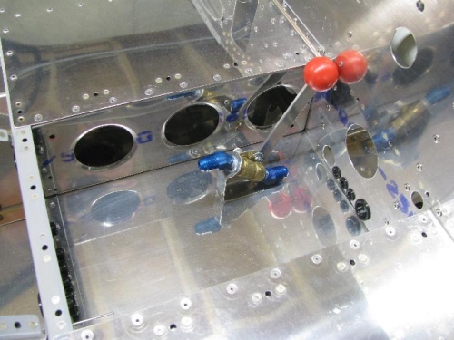

Step 1: Installed the fuel fittings into the Fuel Pump.
Step 2: Installed the the Fuel Pump onto the Fuel Pump Bracket, noting the fuel flow.
Step 5: Installed the other end of the Fuel Valve Bracket Handle to the Fuel Valve handle. Installed the upstream fluid fitting.
Step 6: Installed the downstream fluid fitting through the Fuel Valve Bracket.
Step 7: Riveted the Fuel Valve Clip to the Bracket.

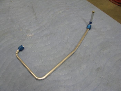

Step 1: Straightened two ft. of ATO-035X3/8 tubing and added the nut and sleeve for the Fuel Line Tank - Pump section.
Step 2: Flared the end of the tube then slid the nut and sleeve against the flare. Made first and second 90 degree bends, then the 15 and last 90 degree bends.
Step 3: After verifying the correct shape; cut tube to length; added the nut and sleeve; flared the tank end of the tube.
