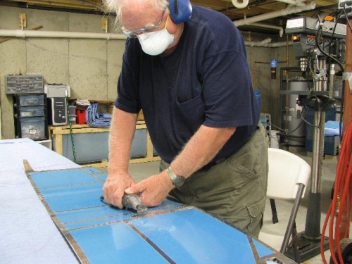

Removed the vinyl and deburred the F-1270-L&R Side Skins.
Pg. 23-05
Step 1: Cut out the wing spar penetration holes in the L&R skins. Used a Dremel tool with cut off wheel to cut close to my guide lines and filed smooth.
Step 2: Marked the skins as left and right.
Cutting Side Skins
Cutting Side Skins
