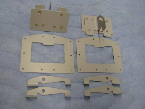

Deburred (2) F-1096 Vent Doublers and (2) F-1093 Vent Doors, (2) F-1248B Fuselage Pin Latch.
Primed (2) F-1086A, (2) F-1086B, (2) F-1087A, (2) F-1087B, (2) F-1092, (2) F-1093, (2) F1096's, F-1205B-L&R, F-1205A, F-1205C, F-1203G-L&R, F-1232B-L&R, F-1254-L&R, F-1234-L&R and F-1202-L&R.
Pg. 23-07

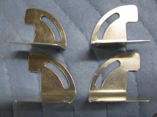

Step 2: Clecoed the Vent Slides, Vent Door Doublers and Vent Doors together. Final-drilled #40 the common holes. Performed this step for both vents.
Step 3: Machine countersunk the holes on the outside of the Vent Doors.
Step 4: Filed the curved slots in the Vent Slides to operate smoothly with an AN525-10R7 Screw.
Step 8: Riveted the Vent Slides, Vent Door Doublers and Vent Door together for both vents.
Vent Slides
Vent Slides
Vent Door Parts
Vent Door Parts
