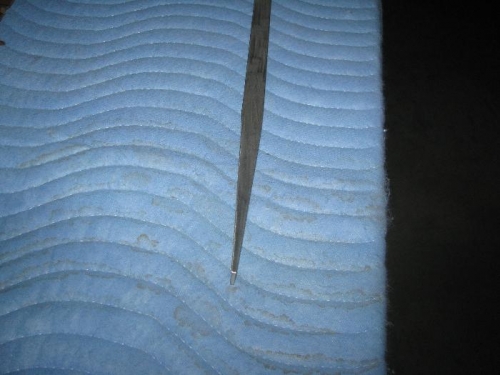

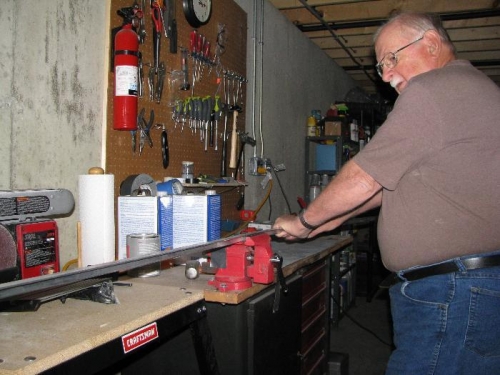

Step 4: Completed the curve operation on the Lt Longeron. Adjusted the vertical displacement by rotating the angle and pulling it back to straight and true condition. Produced the 4 degree bend at the tail end of the angle in a single bend. The tail end was also trimmed for weight savings. Completed the above operations on the Rt Longeron.
Curving operation
Curving operation
