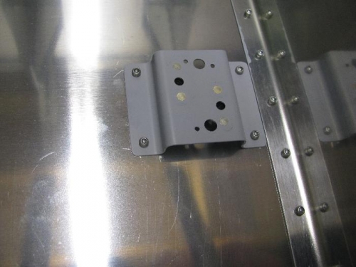

Deburred and primed the VA-188 Flo-scan Mount Bracket.
Pg 22-04
Step 1: MCS and riveted the nutplates to the Flo-scan Mount Bracket.
Step 2: Clecoed the Flo-scan Mount Bracket to the Fwd Fuse Floor Skin. Final-drilled #30 the attach holes and deburred the parts.
Step 3: Riveted the Flo-scan Mount Bracket to the Fwd Fuse Floor Skin.

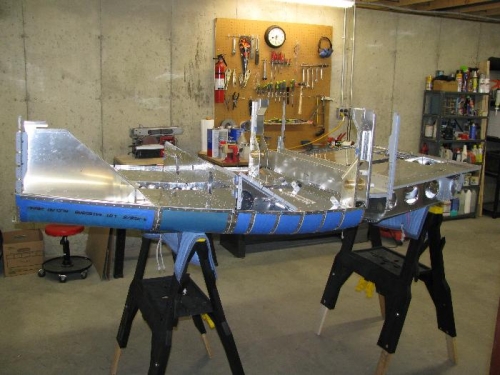

Step 1: Clecoed and riveted the Fwd Lower Fuse Assy to the Mid Fuse and Bottom Skin Assy.
Flo-scan Bracket
Flo-scan Bracket
The Boat
The Boat
Boat from astern
Boat from astern
