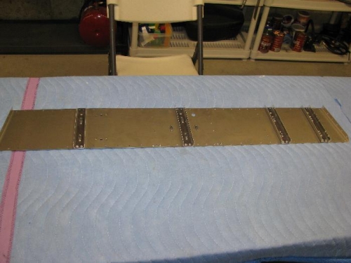

Step 1: Separated and deburred four F-1257 Rudder Pedal Support Channels.
Step 2: Dimpled the aft two holes and nutplate attach holes in the Rudder Pedal Support Channels and Firewall Shelf.
Step 3: Dimpled and riveted the nutplates to the Firewall Shelf and Rudder Pedal Support Channels.

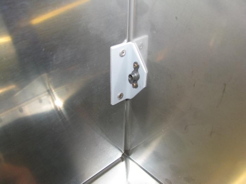

Step 9: Clecoed the F-1201L Bracket to the Firewall Bottom. Match-drilled #30 and clecoed the inbd flg holes to the Rt Tunnel Rib. Match-drilled #12 the Gascolator attach hole in the bracket.
Step 10: Deburred the Tunnel Rib and Bracket. Primed the bracket.
Rudder Pedal Sup Channels
F-1201L Bracket
F-1201L Bracket
