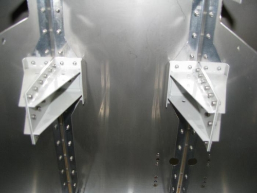

Step 4: Clekoed, final drilled #30 and riveted the Engine Mount Brackets to the Tunnel Ribs.

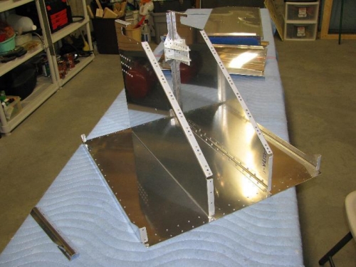

Step 5: Machine Countersunk the four holes in the fwd flg of the Tunnel Ribs at the location of the CS4-4 rivets.
Step 6: Clecoed and riveted the Tunnel Ribs to the Fwd Fuse Skin. Then riveted the Firewall Bottom and Fwd Fuse Corner Skins ot the assy. ( not complete)
Lwr Eng Mount Brack.
Tunnel Ribs/Bot. Skin
